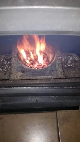

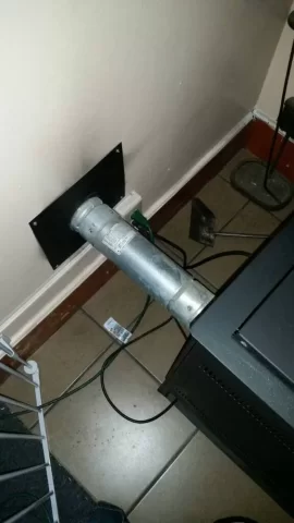

The install was quite simple and straight forward we placed the stove on the pad and put an exhaust pipe staight out the back of the stove there is no bends or anything. I would be inclined to agree with you on the holes in the pot clogging. When I have to dump the pot out I make sure all the holes are clear. At this point a different pellet brand isn't in the cards maybe in a coupleweeks I could. I have pictures to upload if you need more or something more specific let me know the one pic of the pot with a fire in it is on low setting. Side note it keeps saying it can't upload pictures

This is how my burn pot looks after just a short burn. The holes that are covered, now can not bring air up thru the pellets, leaving a dead spot. I'd imagine if I were to leave it alone and the whole bottom were to pug, the pellets would mound up over the dead spot and eventually over flow. But that's just a guess.

Is there an OAK?
Outside Air Kit.
