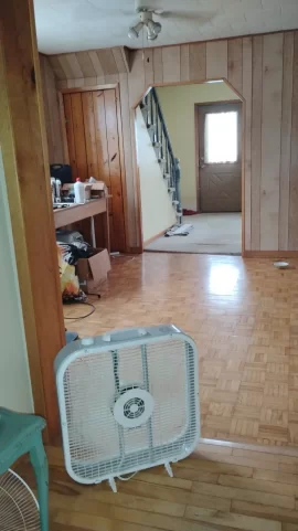

What do mean by pinned out? I can scribble out a picture by hand. My biggest problem is getting heat equally around the house. I have a floor fan and a ceiling fan in the kitchen where it's located. The ceiling fan is blowing down and the floor fan is in a doorway on the floor sucking cold air from the back room, which is 5f colder then the front. The front also feeds the upstairs via the stairs. The kitchen is in the middle of the house. It has two large doorways at both ends allowing good circulation, but the stove is behind the wall separating it from the back room, where as the one to the front is getting hot air blowing directly to it. I've attached a shot looking from the back to the front. The stove is to the left around the corner. The back room is twice the size of the front and is used all day. The front is only used at night.
Where’s the stove?
