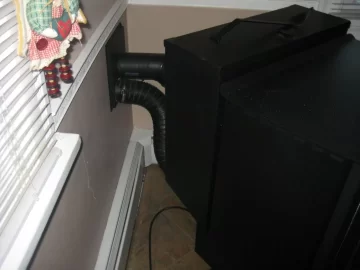

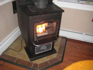

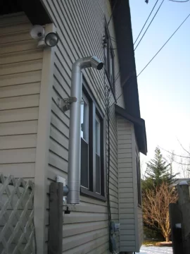

I have a Harman P61A.... Clearance as u can see is at the 9" mark on the Hopper corners. Little further in the back due to the 90 bend, we had to come forward a bit.
No problem with walls.. Never have to run it more than half throttle though. here's few pixs/
