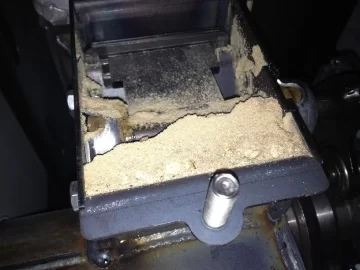

What kind of problems does it cause?
I am not able to lift the bag of pellets to dump into the hopper. I bail them in till there is about 2 - 3 ponds left in the bag and then I hand sift the good pellets out, leaving the majority of fines in the pellet bag. Labor intensive, but what else am I going to do while watching something mindless on TV?
If the fines chamber fills up, it will cause the fines / extremely small pellets to build up against the auger / slide plate assemblies. Which leads to more wear and tear on the auger / motor assembly. This is also been noted many times on the forums, as the cause of the dreaded auger squeal. I've also seen many posts about fines/small pellets jamming up the auger or causing feed issues. They can also end up in your igniter box apparently. (My personal experience was it all building up against the auger/slide plate/auger squeal.)
So just check it monthly, and avoid all those problems. Once you know exactly how much it fills of routinely, you can adjust how often you have to check it.

Here is a picture of a semi-full fines box, this is after half the crap fell out of it (It was overfull)
