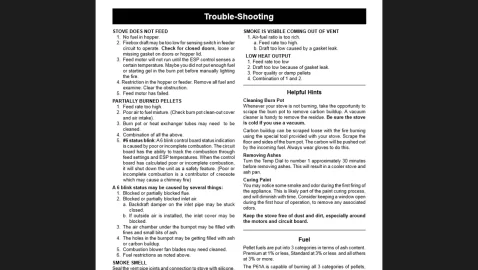

If this is a NEW unit, it sounds like there is a blockage in either the incoming air or the flue.
If it's a used unit, here's the troubleshooting page from the manual:
