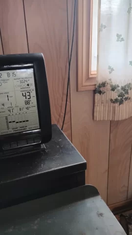

Just curious if I drop the feed rate from 4-3, will it lower my mininum running temp. I'm already on 1, just want to run it all the time, but at 40 degrees it gets to hot. I'm trying to not shut it off and restart it as it's a manual. It's running on stove temp. Haven't tried room temp yet, as my understanding is it will shut off when it gets to hot. 42 outside equals 74 to 76 inside, I've enclosed a photo of a temp gauge on top of the stove showing the room temp and the external thermocouple hanging from a curtain rod. This is early in the day. It's suppose to go up to 55, so if I were to leave and come back 8 hours later it would be baking in here.

The feed rate setting is more for the fuel quality. I have mine set as low as I can go without going into the test section. I believe it does help keep the fire size at the minimum, but it won't cause the stove to run cooler. You might not be correct about room mode, in your case, as you have no igniter. I have a new P43 and in room mode if I select igniter off, in room mode it will keep the fire going. I'm not sure what the stoves that never had an igniter would do....it seems strange to me that the controls would allow the fire to go out?
Even at what the stove thinks is a minimum fire, it can certainly get too hot in the room. I have been making good use of room mode so far this year, however when I got it last Feb, I was running 24/7 in stove mode with the lowest settings and trying to heat the whole house.
