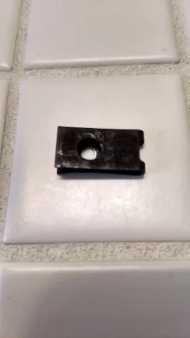

We vacuumed out the fines box of our Harman P61A2 the other night and after we got done we found this on the floor in the back of the stove. It's been running well since. It's appx. 1" long. TIA!
[Hearth.com] P61A2 Part - What Is This?
It's a U-type clip nut to hold the rear shrouds in place.
There are 5/16" hex head screws that are used
in conjunction with that item.

If the clip is wanting keep sliding own just pull it off and squeeze it with pliers and put it back on.
I got a few of the clips at a big box store cheap just painted them black
Interesting. I checked Lowes, Home Despot and Tractor Supply without luck. None of them had a spring nut with a deep enough throat. Perhaps their stocks were low.
My problem is stoves that I've acquired were missing one or more spring nuts. The dealer complains they'd have to order a whole bag of 100 and that's too much to stock;) I've already "stolen" several from my personal stove.
