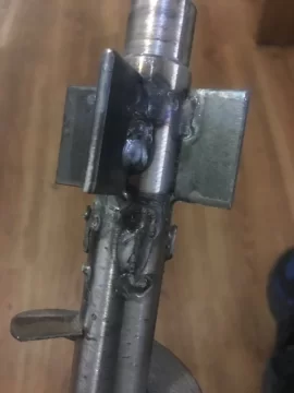

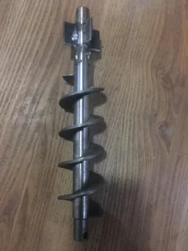

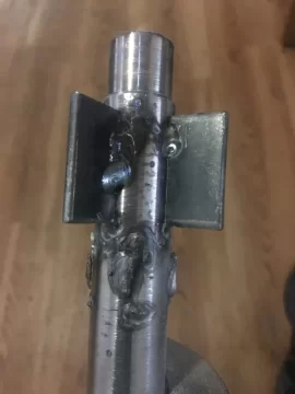

I would yank out the auger and clean and wire wheel the auger and auger chute and also blow out the vacuum hose. Just my 10 cents. :)
See my pics of some dirty Harman Augers here!!!
https://www.hearth.com/talk/threads...n-over-10-years-see-pics.168620/#post-2263431
Also check for the Pox! Auger Pox!
See pic below of a 10 year old auger I just yanked out the other day that was in a Bosca Soul 700 FS made in
Huechuraba in the northern part of Santiago de Chili !! Can you believe it???
Easy fix, we just ground down all the ruff spots with a grinding stone. :-)

thats some ugly yard bird excrement welding right there Don !!!
