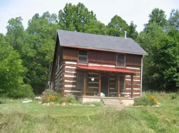

Partial basement with massive sandstone blocks around it - beyond the blocks, there is dirt up to their level - and to make it even more enjoyable, the joists run parallel to the block wall. in other words, there's no wedging anything!
Windows are new double pane. Four 3' X 2' in the kitchen area. Two sliding doors (I hate them). One steel door with big ass glass insert. I know, part of the problem. i hope to get rid of ALL of them when I do my SIP addition.
The front of the house also has several windows, though not as big.
If the doors/windows were the only source of heat loss, I'm sure things would be different. Yes, they are contributing, but I suspect it's not the biggest part of the problem. The 16 X 32 section has a flat roof, with R19 in the ceiling. Top it off with top plates that were not sealed up (I can feel cold air around the ceiling/wall intersection). Unfortunately, I don't know WHAT I could possibly do with that particualr problem without completely tearing off the roof and starting over (which I plan to do in a few years).
EDIT: Ohhhhhh, and even more enjoyable is the fact that each of the floor joists has its own custom spacing.

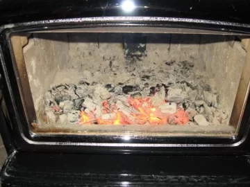

what the coals looked like at 8:00pm

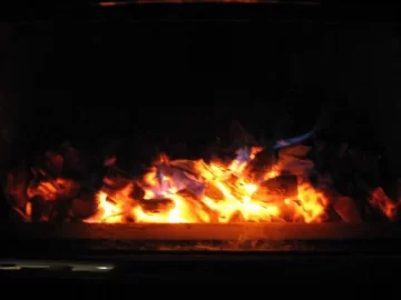

At 10 pm I got tired of waiting for the coals to burn down so I removed some ash and raked everything forward and cleaned the glass. This is how much coals I had for a relight after a grand total of 15 1/2 hours.
same pic one with flash one without.
