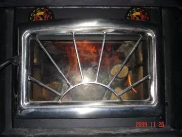

My PE Pacific insert does dip into the 800 range occasionally when it is running 24/7. It also started getting cracked welds too, which were repaired last year. When I inspected the welds during the annual chimney sweep, I noticed some of the internal welds were cracking again.
When I spoke to Cory Iversen from Pacific Energy last year to deal with the issue, he stated that 800 range is not overfiring. He also stated that cracks in the internals have been observed before for stoves that are run 24/7 and are nothing to worry about.
Anyway, I emailed him this September with the pictures I took and I haven't received a reply yet. I called him in September only to be told he was out until Sept. 27. I called after the 27th, and left a voice message along with sending another email. Still no reply.
I have a nagging suspicion that he is avoiding me. I just wanted to get feedback as to whether or not these cracks will continue and eventually become external. I am not in a rush though. My 5 year warranty was extended into the end of 2011, so I have one more burn season to see if the cracks progress.
Any way the point of this message is that these stoves burn hot; and like what has already been stated you can't damper it down to reduce the temperature when it does take off. But make sure you inspect the welds of your PE stove too. Also, I hope to hear from PE soon. Their customer service so far is not as good as last year.

A full load of wood usually peaks in my Pacific Insert at between 750-800s. If I have been burning 24/7, sometimes parts of the baffle and/or side rails will glow a bit when the secondaries are burning as the stove reaches the peak temp. I will usually wait until the stove dies down to 200 before adding more wood. I will open it fully to burn the new wood to about 300 and then damper it down until it is fully dampered. The stove increases in temperature and the secondaries will be burning as it slowly reaches the peak temp and then gradually tapers off. The damper is fully closed, so there is no control left. Also, I have done the dollar bill test, so I know my door gasket is properly sealed.
I don't know if the inserts are different than the free-standing stoves. As far as I know, the internal firebox design is the same, so I would assume they are the same sort of animal. Maybe some Summit owners can add some more info.

That I have no idea, since it not really accessible being an insert. I should clarify that 750-800s is not the stove top. I have the thermometers set up above the left and right sides of the door.
