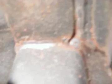

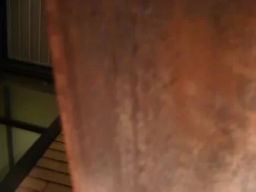

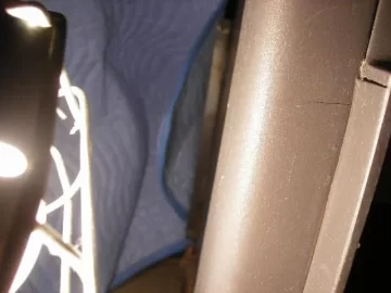

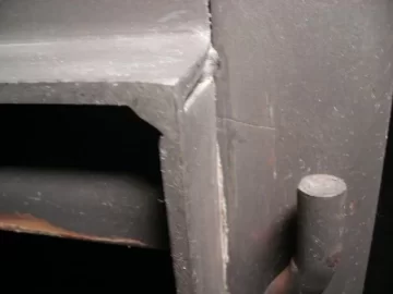

I disassembled the stove and cleaned out firebox, sorry to see some of the same things I have seen in other posts out side welds look fine but face of stove has cracks near top corner of door both sides and inside top of firebox door frame looks like weld is separated. Baffle and rails are warped and crack on front face. Has anyone had any luck with Pacific Energy replacing these things?
Thanks Ty

PE website says warranty applies to original purchaser:
(broken link removed to http://www.pacificenergy.net/warranty.php)
Also says not applicable to "misuse". Scorched handle could maybe be used as evidence of over firing.
On the upside, the door cracks would be relatively easy to grind out using a carbide burr in a die grinder and reweld. I'll let those with personal experience weigh in on this one, but I'd guess that this could still be a great stove with just a little fixin'. If you know a weldor, you're set. If you have to bring it into a shop, it should still be a pretty easy fix. Not sure about the baffle. Might be fine, even though it's warped. Hogz will have better answers for you.
It does look like it has similar issues as Hog's stove and mine. As Madrone stated, if you are not the original owner, the warranty may not apply. Also, as Hog stated, the scorched handle could be evidence of over-firing.
Since you are not the original owner, you do not know how the stove was operated in the past. However, don't let that discourage you. I would speak with Cory Iversen from PE. Their toll free number is 1-888-223-0088.
If your stove was manufactured in 2000, it might be a pre-stainless steel baffle and side rails model. If the stove isn't under warranty, you can pick up a PE baffle kit, that includes a stainless-steel baffle and side rail insulation, for about $200.00. I am not sure how much the stainless side rails would cost, but I don't think that they would too expensive. When I dealt with Cory from PE, he stated that cracked interior welds in the firebox were not a huge concern. However, I think the cracks in the steel should be definitely be repaired, as per Madrone's suggestion.
Either way, talk to Cory and see what he suggests.
