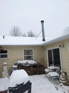

Your chimney is not that tall, so I understand the installers not recommending a damper.

Ok that chimney doesn’t look to tall. Have you tried turning your stove down sooner in stages til you get to low setting? An actual flue probe thermometer will help you know when to start turning it down. Non cats sometimes like to run away from you if you don’t time the shut down at the right time

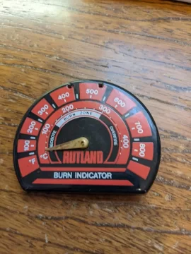

but are you seriously seeing 600 on a double wall pipe with a magnetic thermometer?
can you post a pic of your pipe thermometer?

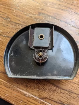

wow that is very concerning to me, I need to get at were the damper is on the stove and see if its closing all the way, here are pics of my gage, I did order another one
[Hearth.com] Pacific Energy t5  burns too quickly [Hearth.com] Pacific Energy t5  burns too quickly
well, that indeed is not a probe.
Are you sure your pipe is double walled? If you have not taken it off for a look, you can measure the circumference.
I had two stove installers who suggested not to do that unfortunately
Not sure why. If you don't need it, you simply leave it open. But you have it if you want to try using it when you have an overfire. I want as much control of MY stove as I can get. but I understand that you hired THEM and you are at their mercy so to speak.
