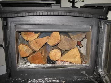

The pictures help. The stove pipe temps are nuts. Hope it's the thermometer.
It looks like the wood is stacked somewhat randomly in the stove. I see some top pieces at an angle. The fire will burn slower if the pieces are put in parallel with little air space between the splits. This is a full N/S reload in the T6.

A bit late to the party, but that picture of the glowing coals tells me there was a leak in the ash door. Happened to me once, learned my lesson fast. Make sure the door is fully closed and the opening fully covered with ash.

Yes, it's easy for a piece of charcoal to get stuck there holding the ash trap door open a little.
