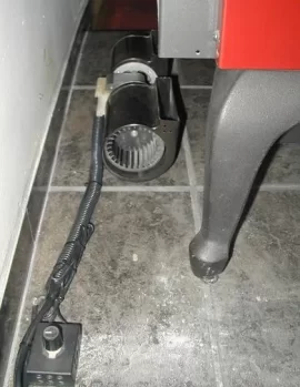

I bought a double blower and put it on the floor of my hearth under the back of the stove and it works great and there was no need to mount it to the stove. I normally run mine on around 25% just to rool the heat off the stove for the ceiling fan to grab and it also helps pull cool air to the back of the stove.
