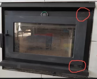

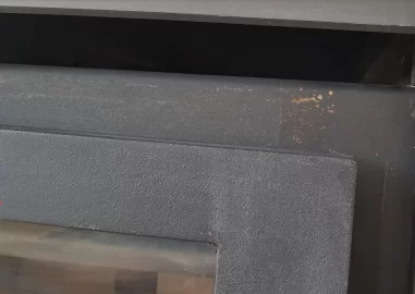

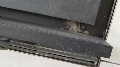

As title said the paint start peeling from the face of our 2 years old FP30 fireplace exposing the metal as shown in the pictures below. Wondering if I need to concern about, is this covered by warranty or just buy a can of high temp paint an spray "the beast" face?

Looks like it needs a retouch. Sand the area lightly with 120 grit, then 320, then 400 or fine steel wool. Vacuum all the dust and wipe down, then clean well with alcohol. I think they use Stove Brite, but I would contact PE tech support and ask what brand they used and what finish. Mask off the surrounding areas well. Open the windows and put a fan in one to exhaust the fumes. They are nasty.
Wire wheel, clean and paint the entire thing with a couple light coats. Do not need heavy coats.
