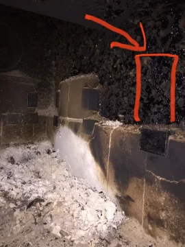

Just to confirm, is the plate resting on the red arrows in the pics? With the end towards the door resting either on added firebrick or tabs welded to the plate? (Please excuse dirty stove, have since learned via this forum to burn only dry wood!)

That’s exactly where you set the side bricks to support the front of plate. 5/16 is best. Stoves should measure the same, but some fabricators had favorite ways of building them, so they can vary. Cardboard template is the best. When sat on bricks, a piece of angle iron can be welded or bolted at the side edges facing downward to hold bricks tight against side walls. I wedge a piece of firewood across the stove to hold bricks in position against walls while setting the template and baffle plate in position.
Yes, the back sets on the horizontal plate. If there is not enough space under pipe to tilt upward you may have to notch the plate at rear to get it to slide back to the rear wall. Your template will show you that if you double up the cardboard to give you an idea of how tight it will fit under pipe. Most rear plates sag down giving enough room to slide the baffle back to stove rear wall. The bricks supporting yours are not normally there.
