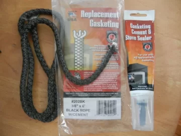

8 years probably means the old girl will need some tightening up. As Bkins stated the gaskets can suck in air and you wont get a proper burn and just blow out heat. The dollar bill test or just break down and replace the gaskets. I found that the new gasket kits with graphite impregnated rope is the better replacement over the old white gasketing. ESP will need to be closely looked at and cleaned. Look-inspect the room temp probe as sometimes pets chew on the end :)
Take a bill and place in door and close and lock door and try to pull the bill out. If the bill comes out easy you have an issue. Need to perform the test all the way around the door as wear is different at hinge versus latch side. GAsket kits are around $10

The graphite gaskets have just started to show up in the last year in stores and was made aware of them not long ago by Don2222. I was just dusting the old white material before with powdered graphite.

I showed in earlier post what I think is a far better and probably half the price replacement option.
About $8 from Menards. I did 6 stoves this last fall.

I know Amazon has the kits as pictured.
Check your local hardware stores or Lowe's and Home Depot also. I know they carry regular gasket ropes but some may have the impregnated ones also.
