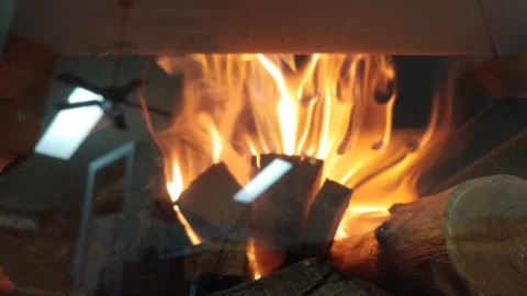

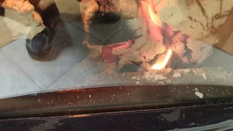

    I wanted to fire up Saturday night, but it got late on me so I went over Sunday AM. Nice top-down start with some Tulip kindling, and secondaries started firing really early, like five minutes or so. ==c
    Hard to see in the pic but upper left of that reflection, the side insulation is forming the hypotenuse of a right triangle with the side of the baffle and the horizontal top of the baffle/brick rail. A little flame was pulling into there, and back to the flue. I'll have to think about that, weather I'd rather have it going around the front of the baffle...I assume so.
    I started cutting air but may have been a bit hasty. There was still some smoke when I looked, though not a lot. Stove was around 480 at that point...I think...shoulda took notes. ;lol
    I opened the air a little, and the plume cleaned up soon after. Nice secondaries off both the bottom and front holes. This was about the hottest the flue ever got. It comes down when you have less secondaries throwing heat up there.
    It seemed to be settling into a nice burn and leveled off about 580, and the flue came down to around 360, so I left with the air like it was, open just a touch. There was even a cute little secondary coming off the boost manifold. ;lol
    I went home and fired our stove, then went back in an hour to check on hers...cruising along, about where I left it. This is with 40+ outdoor temps, so we'll see next fall if it will still run with this kind of control. I feel like I'll have to add a second damper. Hard to believe at 15'.
    I'm getting a little more comfortable, and really starting to like this stove...I might be falling for her. But I've loved every stove I've had so far, so take that with a grain of salt. ;)
