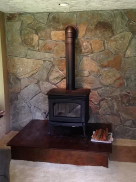

Awesome creation! That has to go in the hearth gallery as one very clever installation. Very nice use of materials there. I think you're going to love that heating beast. Kudos on making such a great spot to display and enjoy it. Well done!

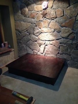

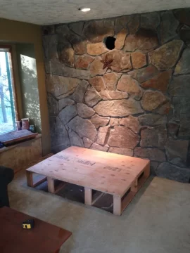

I am also curious about the support framing. Is there additional bracing in the middle? Is that 1 1/8" ply on top? How are you finding the hearth stiffness? Nice and rigid or a little springy?
1/8" sheet steel is quite thin, it isn't providing the strength so the wood structure is doing the work. Did you dent the sheetmetal when sliding the stove into place?
I admire your creativity on the rusted steel sheet. It almost looks like wood in the pictures.
That looks amazing
Is the hearth pretty much built just for that stove, then? Not that you'll be switching anytime soon...
Just one thing missing, FIRE! We'll need another shot when that puppy is fired up and has a hot belly.
I have about 2"-3" from the back to the rock.I like it. I'm glad I read the thread, I also thought the base was made of wood too.
Stonework is nice too, along with the spot. What is your stoves rear clearance?
The rock wall is part of the masonry chimney that has 3 flues in it. On the opposite side is a fireplace with a heatilator. We have decomissioned it because we used its flue to run the liner up for the T6.How is the rear stone wall constructed?
