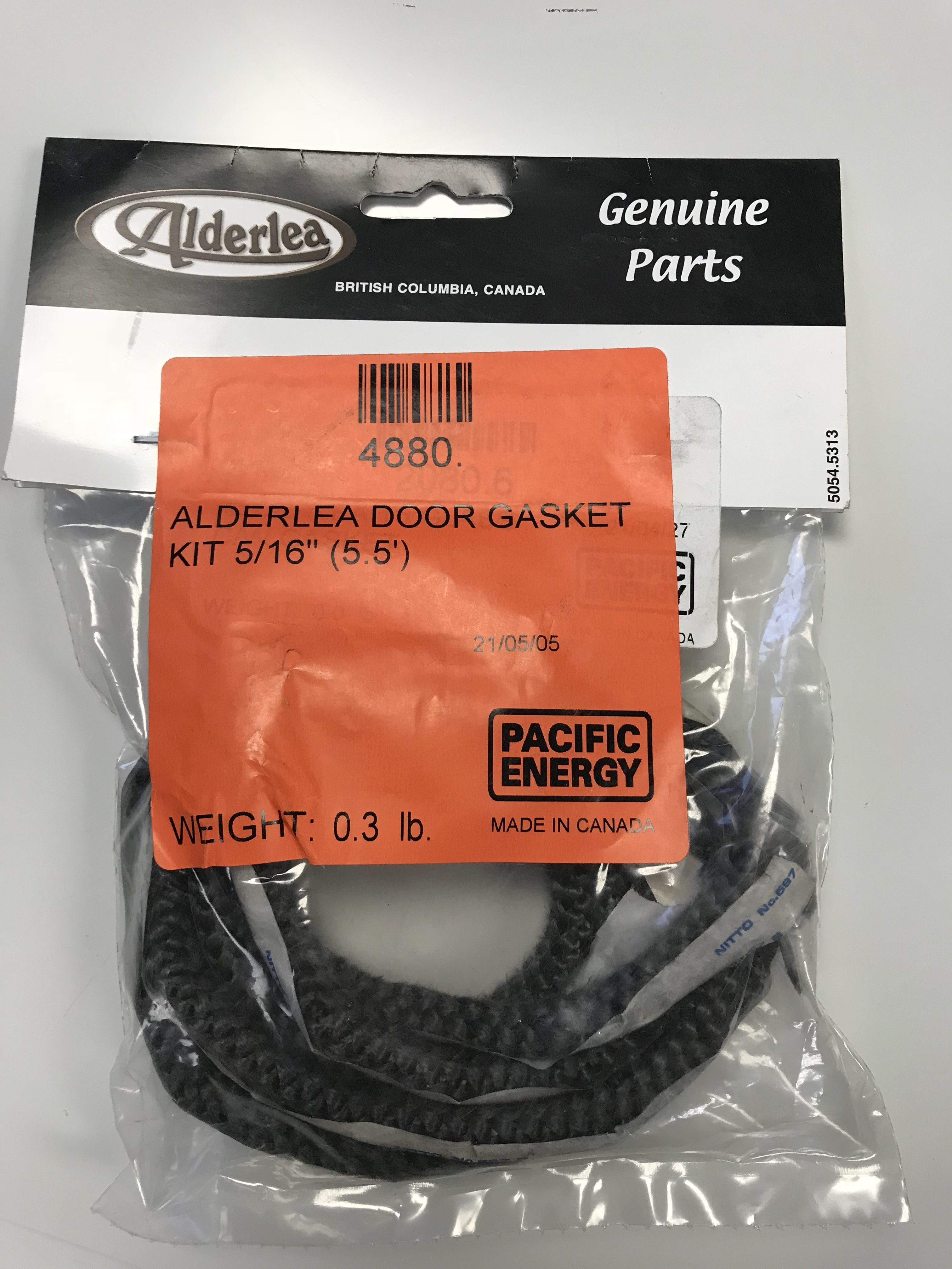

I think mine finally compressed. Is this a special size and shape that only a dealer can provide? Oh, stove is a T5.

PE door gaskets are not the same as aftermarket gaskets. Get an oem replacement. If you don't want to go to your dealer, try online.

OEM it is!
Wow, that ain't cheap, is it?

Ours lasted almost 8 yrs. Then it started to get a little leaky. I tried 2 aftermarket gaskets with bad results. Put in a factory gasket and it was perfect.
