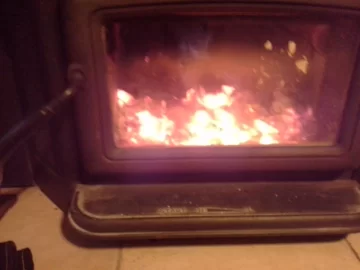

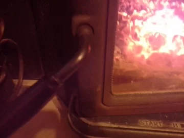

Wobbly ... and a huge coal bed to contend with.
Tomorrow should get it fixed.

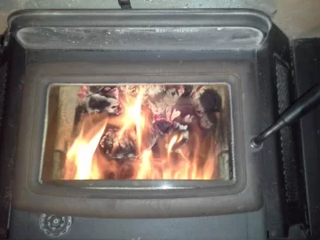

All righty !!

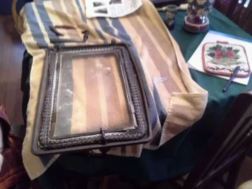

It took some time & a dremel, but mission accomplished.

Triage
[Hearth.com] PE Pacific Insert Door Handle, Again .. Affecting Heat Loss
Cleaned the boost baffle & the door glass while I was at it.

What did ya do with the Dremel?
Cut the pin holding the floppy handle. Took some time.

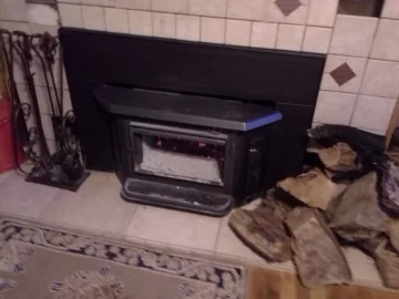

Good job Dix, I'm coming to you when my handle starts floppin' around. I think that's the first time I've seen your setup. Looks good and I like your helper.
Thanks, J !! My helper is awesome .
That's one set up, the 13 is in another location in the house.
