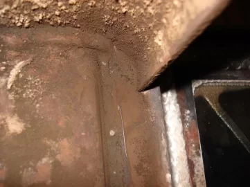

I am new to the forum, but I have been lurking for a while. I have a PE Pacific Insert that I bought new in 2005. It has been operated for four winters now and is operated 24/7 for up to 6 months during the fall/winter/spring season, since I use it as the primary heat source in my house. I have been very happy with the stove.
This year when I went to clean the chimney, I noticed that the baffle had a crack in it. I went to my local dealer with the baffle only to find out that they had recently closed. So I contacted the head office for the dealership, who said that they will replace the baffle but stated that the stove may have been over-fired. This baffle warped after the first winter and the local dealer at that time stated that that is common and nothing to worry about.
However, after the baffle issue, I took the firebricks, side rails and insulation, and vacuumed the firebox. That is when I noticed that there were cracked welds in three locations of the firebox. The first is in the top left (facing the stove) rim that contacts the door gasket. The second is at the top left (facing the stove) just inside the stove opening. The third is at the right top (facing the stove) just inside the stove opening.
I am now wondering what to do. Are these cracks a result of poor welds and/or over-firing. As I stated before, it does see a lot of use, but would that cause these cracks? I am not aware of over-firing the stove, but the baffle has glowed on occasion. Until now I have operated it without any temperature gauges, so I am not aware to the temperature ranges that it has been operated at. To remedy this, I have now bought two magnetic ones now, as per Hogwildz configuration, to go over the door frame.
I am weary that if I were to go to the dealer and try to pursue the limited lifetime warranty for the firebox, that they would just say that it has been over-fired, and the warranty is null and void. Should I go to the dealer? Should I go directly to PE in regard to this? I can reweld the cracks myself, which would be probably be faster, but would cause any issues?
I am just wondering if anyone else has had similar issues and/or opinions of what I should do. Do I have a leg to stand on in pursuing the warranty?

Go to the dealer. If no satisfaction go directly to PE. If you don't you are left with a cracked stove. If they say no you are left with a cracked stove.

That is true! There is no harm in trying. But maybe I should wait to get my new baffle first from the dealership head office first and then pursue it. Unfortunately, cold weather is on its way and this may be a long process.
I love the stove, but I know what you mean by the PE manual instructions in regard to over-firing. It says don't do it, yet it doesn't provide any parameters that would allow you to gauge what constitutes over-firing. The local dealer wasn't too helpful either. I did ask in the past about the glowing baffle/warpage/possible overfiring etc. and they stated that everything should be fine. I wonder if the door rim cracked first, which might have contributed to it running hotter.
I just feel disappointed that a four year old stove would be in this condition.
I'm coming up on season 4 with my Summit Insert. Inspect it every year. The baffles all warp or sag to a degree. But no cracks here.
It is covered under warranty so not a big issue. No cracks in the opening here. Without a thermo, how do you gauge or even get a feel for what the stove is running at or performing at?
I don't use the temp markings so much for exact temps, as I use them for a general basis for knowing where she likes to run at, and if its constant and such. Just to have a feel if its doing its normal thing, or operating different than usual. There may be a chance you over fired, maybe you didn't. Ever see the steel body, top or outlet or liner glowing? Baffle glowing is not all that uncommon, but if the body did, that ain't good.
Put the whole thin in for warranty, and see what happens. These things are workhorses & tanks, but contrary to popular they are not indestructible.
Thank you for your replies. I contacted the dealership headquarters today in regard to the cracks in the firebox. The person (who I have been dealing with since the baffle issue) said immediately that the cause is over-firing. He stated that PE has only ever received a total of 6 fireboxes returned, since the start of their operation. However, he had not yet seen the photos.
The contact also told me that the crack in the baffle is not a crack. He stated his boss told him it is a seam?! When I bought the stove, the baffle did not have any lines in that area. He did however reaffirm that I will be getting a new baffle.
In the end, he also asked me to email the photos and he will see what he can do but stated that it might be easier for me to contact the manufacturer directly. I am not sure what will happen, but I can only hope that things happen somewhat quickly as the cold weather is approaching.

It is possible that the crack at the door rim happened first, allowing air in and causing it to burn hotter than normal. The other cracks are in the side support square stock steel welds and there are no external cracks in the firebox (other than the door rim). I have noticed since installation the air control set fully on Low does not kill the fire. I also asked the local dealership about that observation and they also stated that it was normal.
Is there evidence (other than cracked welds) that would show overfiring? The side rails are in good shape and are not bent or warped. The rest of the stove seems to be in good shape. The door is fine and so is the door gasket. The insulation on the side rails show some wear, but that probably should be expected after being hot for almost the two years of burn time.

Worse case scenario, get the new baffle, and weld the cracks if PE balks. I agree with the lack of definitions, many stove manufacturers are reluctant to state in details what over firing is.
Check the top of the stove itself for any warping. I usually take my surround & grilles off and use a flashlight to check the outer edges/corners of the stove.
Baffle & rail glow is normal in my book, the top glowing is not. Not saying yours did, just saying the selling dealer might have stretched the truth a lil.
If those welds are correctly ground out and rewelded, it should be fine. You won't totally kill the fire and that is normal. I know mine must have the air setting all the way to low once she is up to temp.

I have inspected all the accessible areas on the exterior by taking out the surround and grill, like you suggested. The top seems to be fine. No warpage or any other deformation. Same with the exterior sides of the firebox. The exterior welds all seem to be intact.
Yes both dealerships seemed to have a mix of good and bad information. I agree that the baffle in that area is a single sheet of ss with 90 degree bends. I was pretty suprised when he told me that it was a seam. I don't know what they were thinking?! When I first approached him about the baffle, he didn't even know about the lifetime warranty and tried to tell me I probably didn't have the ss baffle. I don't have a lot of confidence in them anymore.

Well glad I looked again to take some pics. Seems I have same problems. Se photos.
Front upper inner door opening corners both cracked. And mine extended to the outer shell.
Also looks like a few other cracks, some I cant tell if its the edge of the weld, but there is reason for concern now. Baffle isn't cracked but have your other problems.
Guess I'll be calling my dealer also. Worse comes to worse, my neighbor is a welder for the steelworkers union. I'll have him repair if need be.
My faith in PE just sank quite a bit. Now it will depend on how well they back their warranty.

I am sorry to hear about that Hog! It gives you sort of a sick feeling in the pit of the stomach. It appears that the issues seem very similar. Similar cracks in the same general locations. If anyone else reading this runs a PE stove or insert I would encourage them to inspect these areas too. Let us know what you find.
I have sent my photos to the dealership and they have apparently sent them to PE, so now I am just waiting to hear back. I agree with you, my loyalty to the company is now dependant on how they respond.
Like you said Hog, I too run mine fairly hard. 24/7 for almost all of the fall/winter/spring seasons. But there should be a difference between running hard and overfiring. It is a wood stove insert. It is not for decoration (even though it looks nice) and is meant to have a fire in it and produce heat.
Are you going to still run yours as is or shut it down for now? The cracks along the upper door openings are the biggest concerns, since they are allowing air to pass into the firebox and could allow for hotter fires. I am not running mine now and took the baffle, bricks etc out. It is going to be +3 degrees Celsius (37.4 Fahrenheit) tonight. :(
When you talk to these guys about warranty and they claim that any cracking is from overfiring remember to ask them just what the heck else would be a defect that would be covered in that lifetime warranty on the firebox but cracks?

I'm not a certified weld inspector, but I've been welding for years and those look like they could be bad welds to me. The baffle crack looks like a classic case of poor weld penetration. When the weld is ground down, it may appear to be fine, but any stress just pops it apart. I'm having a hard time seeing exactly what's going on with the others, but it appears that there are cracks right next to the other welds, which are examples of stress in the heat affected zone. Once again, I'm not an expert, but I'd be inclined to say those are not from overfiring.
BB & Madrone. I agree. I did some welding when I worked for Budd trailers. I am no pro, nor certified. But the guys that were teaching me were.
I was always taught, a proper weld was much stronger than thew steel surrounding it. And if the weld broke or cracked, it was a bad weld. If the metal adjacent to it tore or broke, the weld was good, and that particular failure, would also prove a good weld. The insert never glowed, not even close. The baffle did on occasion & the baffle rails, but never the face, top, sides outlet, liner etc. I ain't a pro but can tell the face cracks are extensions from the inner door opening corner cracks. Bad enough now face welding is going to make it look like crap, guess they can be ground flat after properly welded. Then I'll have to repaint at least the front of the insert. Hmmmmmm maybe Honey brown????? ;) Trying to keep my head, but the knot in my stomach, thew creeping in cold weather & the worry is just driving me nuts.
Worst case scenario, I have 2 options if PE shafts me:
1. Neighbor is a Ironworkers Union welder. I'll pay, barter, beg him to come clean & reweld properly. Hoping he has portable set up and can do it right where it sits.
2. Pull the Summit, and slide in the Summers Heat. HOLD YOUR TONGUE BART!!!!!!!!!!!!!! But yes the option is being contemplated.
All I know is one or the other will be heating this place this winter.
I don't even care if they give me a new insert or not, I will be just as happy for them to foot the tab of the welding & maybe a can of paint, oh and maybe a new baffle too. ;) Saggy baffle
at a glance it looks like the hull of the stove has cracked probably due to displacement from the busted welds (doesnt look like enough penetration there) in the doorframe corner. im no PE expert but i know stoves, if the weld in the doorframe had held the cracks outside the doorframe on the face of the stove(in last set of photos) would not be there.
And the front of the stove is the coolest part with the primary intake and airwash. I would be trying to clean off some of the crud in the crevices where the top plate meets the stove body and looking for a dye penetrate kit. Maybe Hogs welder neighbor has access to one.
When I busted the Sierra of the same gauge steel and construction a weld popped in the top back of the firebox and the front of the stove body never showed a sign. 900 to 1,000 degrees burns killed it.
Rest Mike. The 30 has never seen over 700 and that was just once. I learned my lesson.
