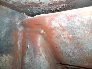

Okay. I found the time. It seems things are even worse than I originally thought. See for yourself:
This is the left top corner of the door rim. The weld is cracked and the exterior steel also exhibits a crack.

This is the top left inside corner area.
  • [Hearth.com] PE Pacific Insert Not Bullet-Proof
This is the right top inside corner area.

This is the boost manifold and shelf. The weld around the hole shows evidence of the weld delaminating. I didn't realize before that the hole goes all the way through the firebox to the outside, always allowing outside air to pass. Is that the area that ensures an EPA rating no matter if the damper is on low?

Here is a closeup of the hole and weld in the boost manifold shelf. Wow that was a tight space to work in to take all these photos.

I know I am definitely watching this thread to find out how PE handles these defective stoves. My belief is that they will accommodate the posters on this site & then do away with the lifetime warranty on new sales.
