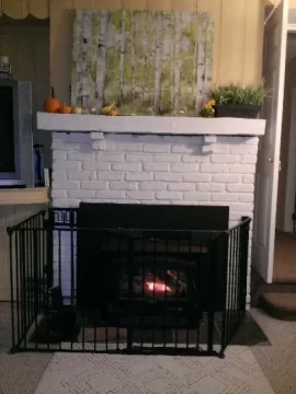

Here is a pic of my set up. I have a kidco hearth gate. Our insert is in a high traffic area of our house so this was a must for us. It's a bit invasive, but we saw it as a necessary evil.
I hope that is helpful, and I hope that insert is a huge blessing to you and your family.
