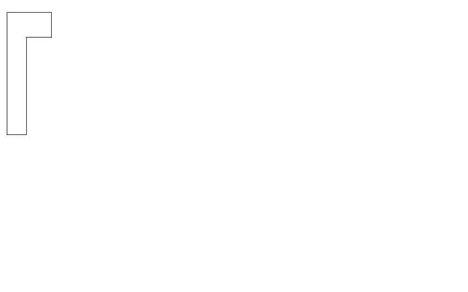

How about a Modification of the firebrick(cut a notch out of the brick) to temporarily
allow me to fit longer logs? Could replace the notch by rotating the bricks and putting the notch behind.
Notch example in pic below. The thumbnail isn't displaying properly, must view the full size.

I don't own a PE but you won't want to make your bricks thinner. Your best bet is to go through the pain of cutting the wood down and using the ends as firestarter or something.
I wouldn't suggest this, you are just asking for trouble & possibly voiding your warranty.
