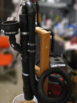

Here's a photo of mine. Was in the middle of some other work, and the pellet duster stuff was just shoved to the side. My wife would kill me if she saw that I made a photograph of my workbench while I was in the middle of a project, so I took a moment and fuzzed it out.
You can see that I had to build it out of ABS; which essentially doubled the cost of the entire gizmo. But it does work well. Got a couple of mods for it that I'm going to try once I have some spare time from doing yard work.

No problem. You can see that I used a 5.5HP shopvac which is about twice the recommended power for the duster. I want to try putting in a baffle to 'spin' the air inside the duster to make it more of a cyclonic separator. This will burn off some of the excess horsepower, but is going to take a while to get to... (low on the list...)
