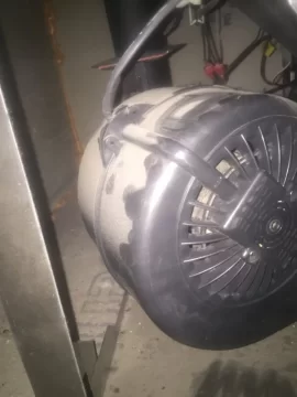

First time posting great site and suggestions wanted advice on my 4yr old Mount Vernon e2 pellet stove after first winter firings the convention blower stops working after 20 minutes and starts making a loud humming noise and stove over heats and goes in a shutdown any ideas on the blower issue ? The stove is fully serviced and cleaned but same results ? Should I get a new blower or is it something else ? Thanks

Take it out and inspect it. Clean (blow out motor with compressed air) and lube the shaft bearings/bushings. Make a test cord and plug it into the outlet and see if it still shuts down. If it does buy a new one.
I just finished throughly cleaning and blowing out best I can , cannot dissemble the motor half the whole unit being held by a nut but it doesn't turn ?
Any suggestions how to take this apart ?
Ok so I finally removed the blower out and totally disassembled it lubed all internals , blew out all dust balls and reassembled put back in stove and prayed and when kicked in made some noise but stayed on and is actually working better than ever for now.

Ok so everyday this motor is getting louder and louder it's hard to sleep now but it's actually working is there anything I can do it ? For the sound or also for lubbing up again I originally used a greasing spray .

blower officially died last night and fixing it did nothing now shopping around for a new blower but want to put a better one meaning closed housing for less debris built up ,Any suggestions that I should go by ?worst case I can always order the same one .
Personally i like the open frame better. Easyer to clean and lube. Usually they are not as noisy. But a framed motor seams to have more torque than the other. Just some of my observations with the ones ive messed with
