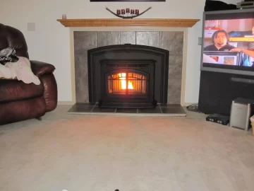

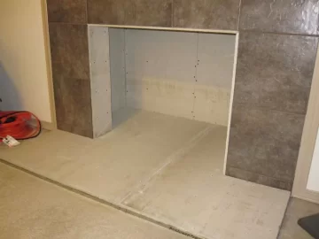

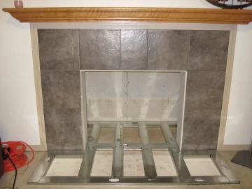

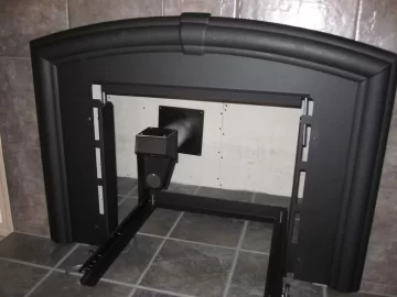

Yes, I did the same. Mine was a natural gas fireplace that I converted to pellet. Same as yours, the bumpout or doghouse style. What you have to do is follow the stove manufacturers installation manual (download them online) which may require certain things. My Enviro M55 required me to essentially build a Durock enclosure with metal studs used as the framework under the tile. Clearances are important. But it all depends on the stove. Like I said, download the manual from the stove manufacturers website and it should tell you exactly what you have to do. Some are as simple as buying a "zero clearance" kit, but your opening has to be big enough to accomodate it. If not then you will have to make the opening bigger. I insulated the doghouse while I was at it and it made a big difference in heat retention even though the exterior wall was already insulated. The cold air would seep thru the uninsulated doghouse, around the stove and into the house. Not any more.
I'm loving the change. The gas fireplace was an el-cheapo that didn't really add much if any heat to the room. It was just for looks. Now, we use the pellet stove for a lot of our heating needs. When we are away at work or at night we let our furnace keep the house at 65F. But when we get home from work or on weekends, we fire up the stove and let it bring our downstairs up to 82F. Heating the whole house to that temp would cost us an arm and a leg with our furnace, but "spaceheating" with the pellet stove actually costs us about the same as what we were spending before but we are a lot warmer.
