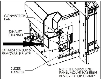

From your manual. Seems to suggest they want a T in the venting. IMO
EXHAUST VENT
(Biannually)
This vent should be cleaned every year or after two tons of pellets. We recommend contacting your
dealer for professional cleaning. To clean the vent pipe, tap lightly on the pipe to dislodge any loose ash.
Open the bottom of the “T” to dump the ash, then vacuum as much of the ash out of the vent pipe as
possible.

I have the insert version so I don't get how I can put in a tee, the exhaust comes straight off the top.
I agree. I have a Quad insert but do have a clean out box on the stove with a pipe straight up which acts like a T. However, not sure how you can clean yours without pulling the vent pipe off your stove. Looks like a potential source for ash collection and blockage. If I was you I would clean it often. You sure there is no clean out plate on the stove near the back? Attached is a pic with an arrrow pointing to where I'm talking about. BTW I love the rail system for your stove. That is awesome.

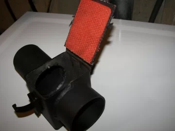

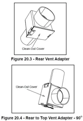

They make a nice adapter for your stoves. Too bad Burnbay can't use it on his stove. Would make cleaning much easier.
Interesting but I'm not sure how it would help. On my stoves, I can flip two of those clamps and the flex liner is released so that I can run a brush up it. With that adapter, it would be a real struggle, if not impossible, to get the brush and rod up there. Also, it really doesn't look like it prevents the ash from falling back down into the combustion blower.
(broken link removed to http://www.homedepot.com/webapp/wcs/stores/servlet/ProductDisplay?productId=100660183&storeId=10051&langId=-1&catalogId=10053&MERCH=REC-_-SearchPLPHorizontal1-1-_-NA-_-100660183-_-N#product_description)
While looking for the miniature vacuum attachment set that I bought, I found this gem. It has the plug and length of clear tubing that would work perfectly, as my cobbled together version does, to snake back into the combustion blower area to vacuum out the ash as you thump the flex pipe with a BFH.
It's not to clean the vent pipe it so you can vac the blower area and where the ash drops down from the vent pipe. As with my CB1200i you must undo the clamps and pull the vent pipe to run a cleaner up there. Open that little door on the adapter, stick the vac in there and tap away on the vent pipe and it sucks it up all nice like.
Where did you get it and how much? It just might be worth it. Does it fit the exit of the exhaust blower without a problem?

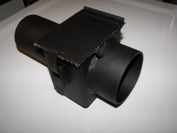

My stove is a CB1200i and it came with an adapter. See pic below. Ebay has the adapter that says will fit your stove. Search under "Quadrafire Vent Adaptor Rear Pellet" which should give you 2 hits. They both look the same to me and have the same part number yet one is listed at $39 and the other $85. The part number is 811-0620. Hope that helps.
There is a clean out plate, I suppose I can put vac in there when I clean out flex liner, I was just curious on day to day operations on if stuff would just fall down into exhaust port, but as I have learned i can just get some tubing and snake it down through it and vac out. How often do you think that should be done? My rails were on back order , my dealer called yesterday and said they were in. They do seem to be a great luxury. Thanks everyone

I believe it's just a couple of screws and I remove it, if I'm talking about the right thing. It located below exhaust port. I'm still trying to get familiar with the stove, so this is a huge learning process
That's what I thought looking at your manual which could explain why you get rails for your stove to make it easy to get at it. Too bad they don't make an adapter clean trap for that stove or do they??? Did you call your dealer and ask if they make an attachment that you could put between the vent pipe and stove to make it easier to clean? I know I would.
If I have time today I'm going to go pick up my service rails from dealer, I've got a list of questions I'll add that to it, thanks a bunch
