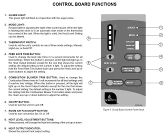

    Here is what I got from the GF55 manual. Looks like it has feed trim and combustion trim settings. See #4 and #5 below. As for you pellets you might want to start your own thread! GF55 control.JPG

    Actually my panel looks different.

    My control panel looks like the one in the picture above. I actually just checked and my feed trim is set to 4 and combustion air is 5. You hold down the combustion air trim or feed trim button and hit the arrows up/down to adjust (if your control panel is like the one in the pic above). Feed trim is the auger trim.

    Both my pellet stoves DO NOT have the control panel shown above. I find that odd. I am able to control temp levels (1-5), auger, fan (on or off), power (on or off), auger trim (2 sec, 3 sec or 4 sec), and can change control switch to manual, high/low or auto/off. Both units were purchased new. Manual dated 2008.
