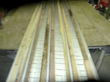

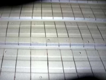

A while ago I said that I would post photo's of the storage bin cooling floor that i was working on. I have the 12' X 3' sheet of roofing that I cut slits into and the bottom showing support of strips of wood. I ended up with all 4 speeds of the furnace fan operational, each controled by a switch. The fan discharges under the sheet metal roofing and then blows up through the slots in the roofing. My intent is to be able to put warm pellets into the storage bin and then provide additional cooling and drying for them. I am going to see what I will need to do as far as how to handle the pellets that have just come out of the pellet mill. I have a horizional cooling tower that will hold about 500# of pellets but my concern is that this will not be enough as the pellet mill would cool down while I move them. I may need to adjust that volume so that I can continue to make pellets for a longer period time between sending them for storage.
