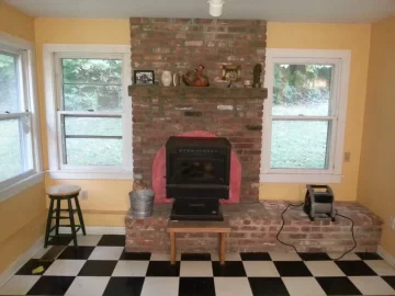

The pellet stove is on a brick ledge and comes out of the fireplace. So it's a free standing stove that is using a small fireplace chimney. Totally weird and not to code.
We are considering moving that pellet stove over to the wood stove area - since a pellet stove install would be cheaper. Then, we would need to decide between a pellet or wood stove insert for the fireplace. After the horrible time we had making fires and dealing with the our old landlord's wood supply, I'm also drawn to the convenience of the pellet stove. I'm torn! Do pellet stoves heat as well as the wood stoves?

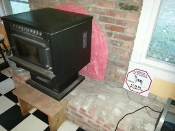

Photos...for your enjoyment. Don't laugh too hard. Looking at these beautiful photos of others stoves and inserts makes me pretty embarassed...but we just got the house and we are going to fix this silly looking thing.
The owner put some kind of board behind it and painted it red.
It's a Kozi MX - or something like that. I'll have to look at it closer. It may not even be a good stove...I guess I should look into that too.

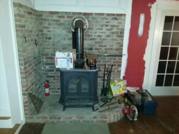

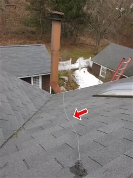

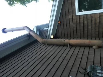

I know it's a pellet stove forum, but here's the wood stove (currently being used to hold our supplies while we fix up the house) and the pipe for the wood stove (one chimney guy said $2300 to replace, the other said it is an internal pipe, not external and needs to come down, online people say it is probably okay). I want to have someone else look at it. btw: it's held up by wire and a broken bracket. Another fun thing to fix :)
[Hearth.com] pellet newbie lurking around [Hearth.com] pellet newbie lurking around[Hearth.com] pellet newbie lurking around
I have little to offer but love the wire. at least they tarred the roof where eye screw is
The previous owner was a piece of work! He had some "interesting' ideas on how to do repairs. I can't believe he lived here for 20 years like this! When the house inspector came off the roof he was laughing and told us he took a picture to show his buddies...I guess they get a kick out of the do-it-yerselfers that really shouldn't be doing anything themselves!

Your gonna need to remove the wood brace under the pellet stove and replace with a non combustible remedy.

I think your gonna need a larger pellet stove and if that is what you decide to use as primary. Putting it where the wood stove is makes better sense. A 60K to 70K pellet stove might just be enough to heat what you need. Might have some cool spots upstairs???

Based on that layout, the wood stove probaly carries the biggest load heat wise. With a big pellet stove, you could probably heat the whole house with just that. Then the fireplace is secondary.
