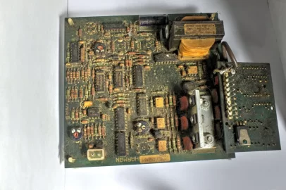

Actually I repaired the board myself about 7 years go. It's actually a two board sandwich. What happened before is the connector that connects the two boards together had a fried wire. It was the 110 hot term. I jumped them with a wire. Worked great. Do you know where I can get the pot? Thank you

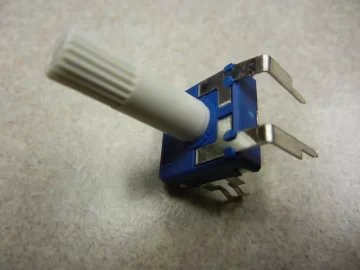

Digikey is one source others have listed sources for electrical components. I replaced the pot switches on two Harman boards but the switches were available on Ebay.

The back side of the little buggers are usually marked. There is two that I see on the board and they are if cheap enough why not replace both and not worry about failure of the remaining one and the resulting work and down time?Maybe someone else can chime in with some help. Electronics are not my thing.

Now I'm confused. I think you're talking about the blue ones. That's the interior thermostat and mode one. Those work fine. I know that because when I turn the dial on the thermostat one it kicks in where expected. The problem is that when the thermostat reads the stove is hot enough the combustion blower shuts down. The combustion blower should simply go from high to low. Low is just to keep the stove from going out. Then it kicks back into high when the present temp drops enough. That's my problem. I assume that high is full voltage and low is much lower voltage which reduces the combustion blower fan speed. I can clearly hear the difference. This is a very old and simply stove. The feed rate is completely manual. That's what I like about it. I know this stove very well and it's so well made. It is possible for me to run it the way it is but controlling the feed rate. It's on high constantly in the winter anyways. I also use it to heat my hot water. So excess heat is stored in water barrels. There's a barrel next to the stove where heat it stored and another one next to my furnace. The furnace barrel has 100ft of pipe in it which preheats the tap water going into the furnace.

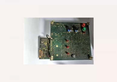

I'm not sure what I'm going to do. The thing is that it works and I can control it with the feed rate which is mechanical. I looked at a wiring diagram and the combustion blower has 2 wires that go directly to the board. That tells me the problem is definitely on the board. The combustion blower gets 110v on high and a lower voltage on low. Something on that board is lowering the voltage and it can't be something small for that kind of voltage. I'm shutting the stove down again and I'll see if I can trace terms 6 and 10 on the board. It would be great if I knew what part actually drops the voltage.

I'd get a can of air and clean the board first, you may find a burnt component, or there could be a short in the dust.

Also I would suspect one of the power transistors is likely bad. The power transistors are the components attached to the heat sink. They are the components responsible for speed control of your various motors. I also see a lot of bridging of components with dust, a tacky dust at that. Clean the board first, especially the chips as they are very sensitive to dust bridging. After cleaning reinsert the board and try it again.
