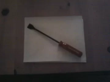

You might want to get a gasket scraper (available at Sears) in a convenient size to scrape the burn pot. Does a great job for me.

My pellet stove tool box contains the following: * A wearable LED headlamp to better see the insides. * A soft 3"- 4" paint brush for brushing the insides (remember to turn on the exhaust fan when doing this). * I use the Harman supplied scraper and a screwdriver for carbon buildup. * A 1" long nail to clean the burn pot holes. * A 1/4" soft bristle paint brush to brush fan blades. * Rags for wiping hands/glass/stove top. * Pliers to loosen the wing-nuts on the burn-pot clean-out cover. * Appropriate sized wrenches/ratchets for loosening/tightening any bolts/nuts. * I use the pellet stove Sooteater for exhaust vent. * I also use a wet-vac with a HEPA filter for vacuuming. However I rarely vacuum inside the stove (except when final spring cleaning). I only vacuum the loose ash that gets outside the stove. I thoroughly brush everything to the ash pan. When cleaning the ash pan area I brush the loose ash into a dust pan.
