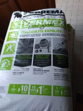

I am installing my pellet stove my chimney is 7mtrs am doing 2 MTRS in 80mm then the 5 MTRS at 125 mm the run the run is straight up the existing chimney I just found a note in the instruction book saying the run must not be more than 6mtrs any advice would be great I think it should have a long run above the roof line any help would be great

Hi it's all straight so there is no issue going up a size with the pellet burner from 80 to 125 thanks for your help the make is an extraflame vivano 10kw I am also filling the chimney with vermiculite insulation

Hi it's 80 mm to 125 no bends just straight I have added pictures it's a extraflame Viviana evo 10 kw thanks for your help
