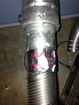

First I want to say this is not a permanent venting solution and it is not recommended for unattended use.

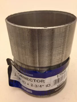

To test a stove without too much fuss, I found a 2-3/4" ID muffler adapter pipe at auto zone.

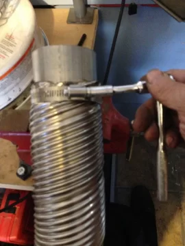

The OD is the same diameter as a pellet stove exhaust vent flange. By using a radiator type clamp to clamp down the 3" flex venting and some foil tape, it can be attached to the stove adapter fitting in the exhaust system.
The other end is the easy part. Just add a flex pipe adapter and connect that to a stove adapter.
Great for a temporary connection that is safe as long as the stove has the required clearance and floor protection.

Actually, I am using this piece to test a stove, so I do not have to re-adjust the height of the venting to accommodate the vent flange just for a one time test.

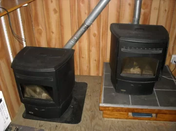

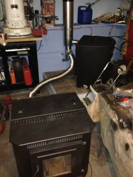

It is so I can test out a stove in my workshop. Just pull the workshop pellet stove out a little and plug in the the test stove. :)
Like when the auto mechanics put a flex pipe on the car exhuast to the outside so they can run the engine inside to test the car. :-)
See pic
Stove exhaust flanges are different heights, this way I can test any stove no matter how high the exhaust flange is off the floor! :)

I do that in the shed with a T
See Pic below

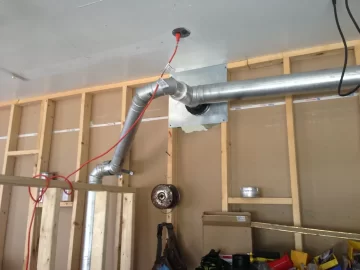

I have a 3-4T doing this for shop stove and office stove
Wow that is a little more permanent than I would like.
Also it may be hard to keep that big horizontal run clean?
3" in to 4" in to 6" Class A
Wow, Is the 6" class A for a wood stove?
I hope that power cord is not too close? Looks like that safety tag is in danger?
