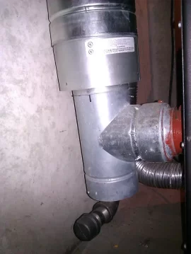

It appeared that Don was thinking that anyone could make one instead of buying one. I just was letting him know that someone did just that last year.

I made one for my stove when I put it in, I didn't know anybody else thought of it. Used a 3/4 street el with a conduit connector to hold it in place. Silicone to seal. Siliconed the cap in place and put 3 small sheet metal screws to hold it forever. My old ash vac hose fits over it and the other end oh the hose fits into my Ridig shop vac hose. Works super.
I bought one and love it. It was a good snug fit and I put a screw in it also. Every other week I hook the vac up and give a tap up and down the vent pipe (not sure if that does anything but doesn't hurt). After cleaning the stove then, I also leave the vac on when I first fire the stove and catch anything the exhaust blower might blow out. I do this for maybe 5 seconds then pull the hose and cap it back off.
