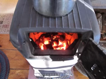

I still use coal occasionally in an old Warm Morning coal stove if the temps dip into the single digits for several days or if we lose power (full manual, no electric parts). The coal stove resides in the kitchen which offset from the main part of the house where we have a Harman pellet stove which takes care of most of the house on most Winter days. The coal stove can also take short pieces of wood if we want to take the chill off the kitchen at times.
The coal stove can throw off significantly more heat than the pellet stove and when loaded and properly attended to can burn easily through a night and into the morning. When I first started burning coal I had a trailer I would take to a local supplier and get about a ton and a half bulk loaded from a railside coal tower, take it home and shovel it into a coal bin in my cellar via a chute (old farmhouse had the bin and chute before I bought it to feed an old Crawford #21 coal furnace which I updated to an oil furnace). More recently I've bought coal in bags by the ton (current prices in Central MA... https://squierlumber.com/product-category/coal/ ). PA coal prices may be less.
I don't think I'd want to heat with coal full time. A stoker that is more automated would likely be easier to use than what I have, but coal ash and clinkers are more difficult to dispose of that wood pellet ash and the quantity of coal ash is significantly more than that from a pellet stove.
