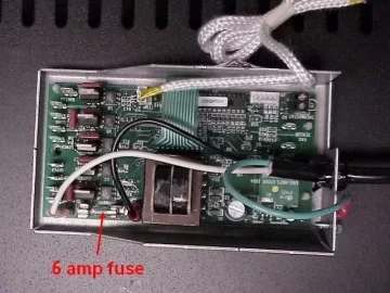

hi to all.this is my first time here and i really need some help.i have an england pellet stove model 25-pvd.it has been running great but now all of a sudden when i build a fire in it the pellets feed for just a minute and then stop.once the fire is almost dead they start feeding again.it just cycles this way and never feeds the way it should.i am wondering if the switch that protects it from overheating could be going out.is there any way to test this switch?i was thinking about jumpering it to see if that would make it work again.the stove is not overheating at all.it barely gets warm enough to keep the rom air blower going.and no i am not going to jumper it and leave it that way.just long enough to check it and order a new one if that is the problem.so any ideas?can the overheat safety switch be jumped temporarily?here is a picture of the overheat safety switch.it is the what looks like a white wire on the top of the picture.thanks for the help.

From the sounds of it, I wouldn't suspect the overheat sensor. Are you seeing an E for error on the control panel? I would suspect the thermal sensor on the back of the firebox that checks to make sure their is fire in the burnpot before augering in more pellets. Is that sensor clean and in the correct position? The other sensor I would check is the vacuum switch. Give me a moment to check the manual if Mike doesn't chime in shortly.
PS: Whay was the control box pulled out?
no it just started doing it yesterday and there tech support is cloosed until monday.and no erroe codes are showing.and if i can figure out how i will add englander to the title.and the control box pic is one i got off the englander website.
