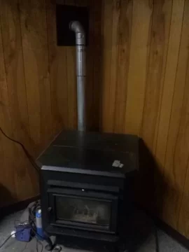

I have an http://www.americanenergysystems.com/ Magnum Countryside pellet stove.. 50k ish BTU rating.
It has 5 settings, 1 through 5.

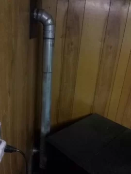

The chimney exits out the bottom floor of my bi-level home out the western facing wall. I have tried with a cap and deflector straight out, as well as with a 90 degree elbow facing south at about a 45 degree angle (per my local stove dealer's suggestion). There is a fresh air inlet pulling air from outside, and the damper works off the furnace blower.. you regulate how fast the air moves out of the stove, adjustable manually.
The chimney exit is 68 inches above grade. There is a 52 inch vertical chimney section, indoors, and a 24 inch horizontal run. 2 90's are in the chimney. A T-90 at the bottom and a 90 to go out through the wall.
It seems that no matter what I do, or whatever pellet fuel I try, I cannot burn the stove at 3 or higher when the temperature is below 10 degrees. I can completely clean the stove top to bottom in the afternoon, set the heat on level 3, and within 6 hours or so the fire pot is full/overflowing. You can turn it down to 1, scoop out some of the excess pellets, and it'll eventually clean out, but as soon as you turn it back up, and the temp is below 10 degrees, the same crap will happen. I've tried running the draft all the way open, half way open, all the way down to nearly closed (like the manual recommends, once you get the flame how you want it)

I've attached 2 pictures of the stove. (yes, the propane cylinder next to the stove is legit)
Can anyone offer any input? What am I doing wrong? I've gone back and forth with AES for advice.. Nothing changes this issue.
I'm ready to sell this stove.. I'm sick and tired of not being able to turn it up when I REALLY need heat. Sure it works good above 10 degrees but it goes below 10 for sometimes a week at a time or longer here.
Thanks for any input!
