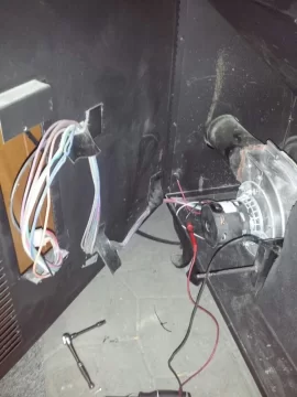

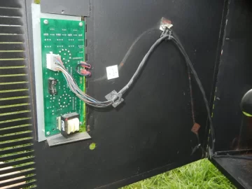

Picture of wires for the exhaust fan and back of board for reference
  • [Hearth.com] Pellets piling up in firepot below 10ºF.. Tired of it!

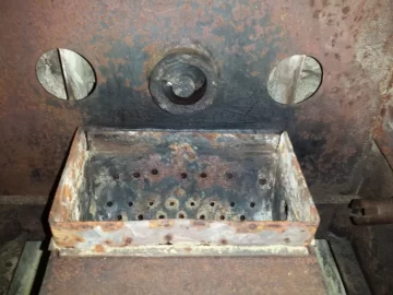

Here is a picture of the burn pot, seated.

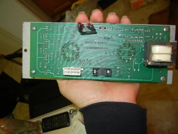

Also, AES says they will test my board for $35.. probably worth it, yes?
Sounds good, but what will they charge you for a new one or if bad allow the service fee to be deducted from the purchase of another? I seen they had some with paint over spray for $148 +s&h. Before pulling the trigger on a new one PM me as I have a unused one as I pictured
Take AES up on the test and you need to ream those holes at the bottom of that burn pot out you want all combustion air to come out below the pellet pile and not above it. I can't tell if the pot is fully in its receptacle (cardle) but there should not be any air coming around on the outside of that burn pot. My bucket of parts originally was pulling most of the burn air around the outside of the burn pot (remember my stove is not the same as yours but it operates the same way) which along with a gap at the top of the feed assembly caused major air flow issues and pile up. That fire should be standing upright not the way that picture shows. What are those two circular holes doing there? I guess I best see if I can find my manual collection.
There is supposed to be a firebrick that covers the holes behind the pot. Might help to plug the holes the stirrer rides in.

The stove is in a state of disassembly.. no worries there. I run the stirrer.
Bioburner, that isn't the exhaust fan in your pic, or at least my definition of the exhaust fan. I'm talking about the other fan, the one that blows air out the chimney. Is that one supposed to be variable?
I have the plugs and the brick board installed when running.
The picture was to show how the exhaust fan is connected to the stoves wiring. Don't ask me why they run the electrical across from the control board. smokey had concerns that maybe the exhaust fan was improperly wired so a picture of properly wire unit I thought would get that ruled out for you.
How big should I make those fire pot holes, once they are clean? A few sizes bigger?
By reaming them out I am saying clean them, that picture shows them with build up inside some of the holes. That restricts air flow through the pellet pile and forces the air to go around it. Ash glued to the blades on the combustion blower reduces the airflow the stove.

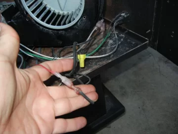

This may not be stock wiring? Not sure.
I don't think that's factory:) Used stove conundrum. May very well explain why not proper fan control because the CB is fine. Attached picture is factory
