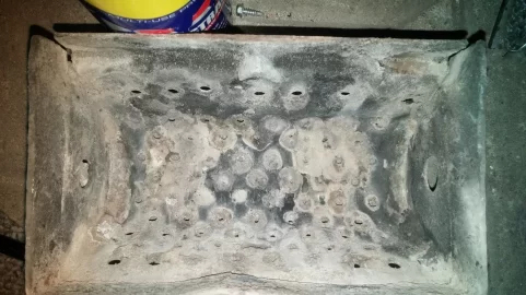

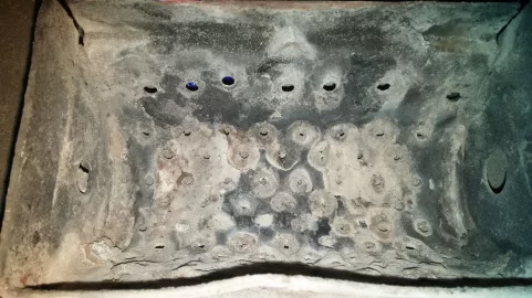

Here is what my burn pot looks like after just 3-4 days in very cold weather. Bigger holes needed or something else?
  • [Hearth.com] Pellets piling up in firepot below 10ºF.. Tired of it!

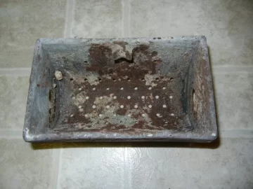

That's not a OEM pot. Could be the problem. Heres picture of one out of stove that's OEM
It's OEM.
In a stroke of brilliance a couple years ago I drilled some extra holes in the back piece under the pellet diverter to try to alleviate this issue. I purchased a brand new burn pot, compared it to the one I had, then returned it, as it was identical other than my custom holes.
