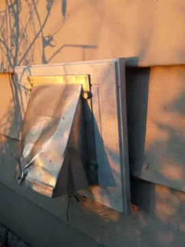

Don't try a 4" yet, how big is your current OAK and is it totally clear they have been known to get plugged. While you are at it what are you using on the end of that OAK outside. People have been known to have that so restricted that it causes problems.
Read all of this https://www.hearth.com/talk/threads/countryside-baby-magnum-feeding-too-fast.122308/ burn pot pictures please.
The outside air kit has 3 inch piping. I attached a sweet picture. It isn't plugged, and I remember over the winter when I pulled the hose off the stove, plenty of COLD air was coming through it.

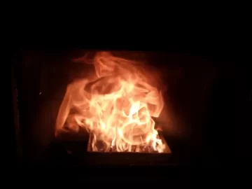

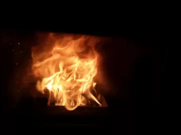

Regarding the fire pot picture, here's two I took and sent to AES in winter..
There are two pictures of the flame at -5 outside. One with the draft knob out only slightly, the other with it out all the way.
I wanted a picture of your burn pot in its cradle in the stove and outside. I am looking for warpage and air hole status.
