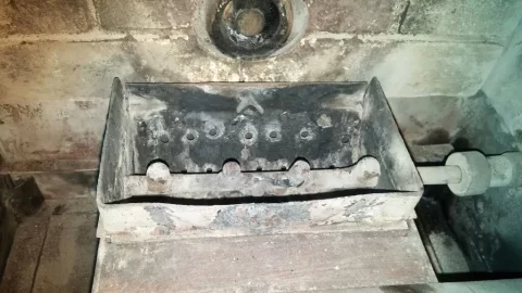

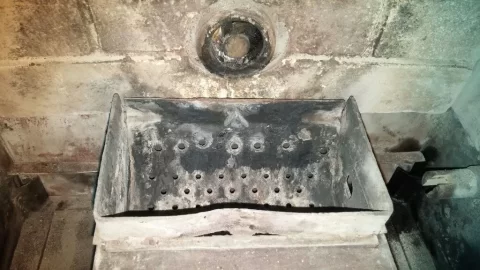

Here is what my burn pot looks like after just 3-4 days in very cold weather. Bigger holes needed or something else?
Have you cleaned out those holes?
And that warped section isn't going to help any, you end up with the burn air bypassing the pellet pile on the outside of the burn pot.
Those additional holes above the original ones also rob air from the pellet pile.

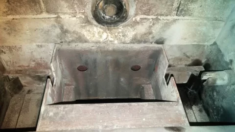

What shape is the receptacle that burn pot sits in?
I was looking at the top and the area where the pot seals into the stove. Notice my picture shows a solid heavy upper skirt for a proper seal with welded corners. Maybe they had China produce a batch of pots.:(
Yes, I clean them out during every thorough cleaning.
Pictures attached.

You have a serious issue with the warping of the burn pot in the front and it not sealing properly.

Can try but its going to be probably brittle. If it don't work PM another me another message and I have a well made pot used.
Or get a new one.
You might be able to use some gasket to seal that gap until your new one comes.
For sure, that's why I said "temporary" ;)
I'll run it a bit and see what happens with it. Just that little gap can really screw things up, airflow wise eh?

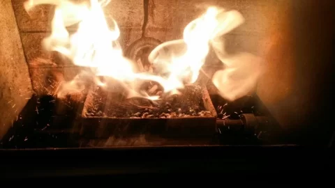

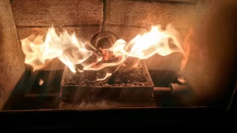

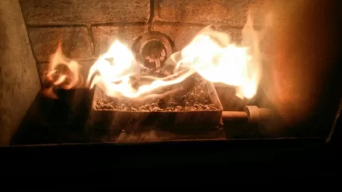

Here's my stove, less than 12 hours of burn time after a thorough cleaning. Temp was between -19 and -2 all night.

Fire should be rolling up straight
Reactions: SmokeyTheBear
As you can see by the pictures I just posted, no. <> Same pile, different day.
Flame looks lazyish. Where is your draft pot set? As Smokey and Bio pointed out, a small vacuum leak in the burnpot area can do that as well.
You mean the draft knob? It's pulled out 1/4 inch or so. When I went to bed it was burning fine. Obviously not anymore, but the firepot is darn near plum full..
