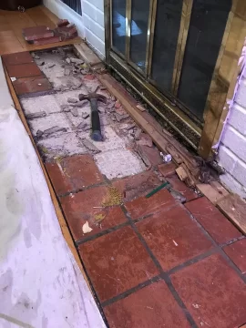

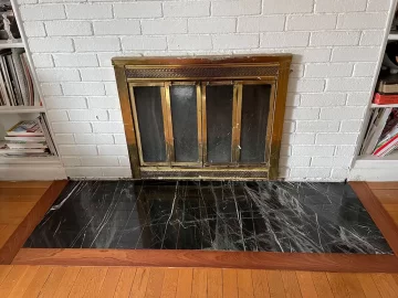

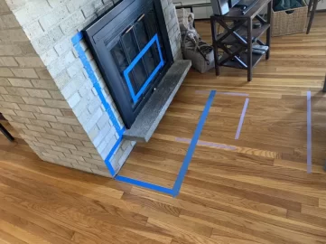

After we purchased our 1920s home in 2014, we never used the fireplace. The previous homeowner had allowed the hearth to decay to the point that it was “perceived” unsafe to walk on. Fixing up the fireplace was something we said, “we will get to eventually.”
In 2018, during Thanksgiving dinner, we noticed a robust breeze coming down the chimney. We decided then, to look into fireplace inserts. We never considered a gas insert because we wanted a method that could supplement our heating without adding to the winter utility bill.
In 2019, we had the structure of our hearth redone. It cost us about $750 for a handyman to remove the old tiles and concrete and redo the floor structure under the hearth.

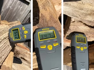

Sadly, it looks like I just unknowingly ordered a half of a cord of green wood. Yesterday, I received a 1/2 a cord of firewood "Seasoned for two years" according to the seller. :rolleyes:
I am already hearing the beginnings of understandable "dissension" from my significant other.

Were those moisture readings on the surface of the splits, or were they re-split and tested on the freshly exposed face of the wood?
BioBrick, ECO Bricks, Redstones, Tractor Supply bricks are all ok. If you are looking at pressed logs, be doubly cautious. There are many sawdust logs on the market that are compressed under low pressure. They burn quickly and create a lot of ash. Then there are some highly compressed logs made under great pressure. These logs are very dense and hold their shape as they burn. They're a little harder to start, but burn 2-3 times longer than the cheaper low compressed sawdust logs. Northern Idaho Energy Logs (NIELS) and HomeFire Prest-Logs are good ones.

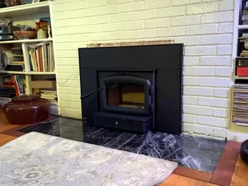

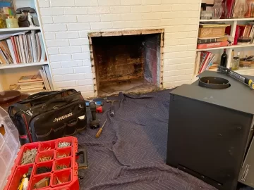

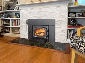

Installed on September 2!!
We are sourcing white marble tiles for the surround so, there is still a little bit of work to do.
The reading was not taken from a freshly split log. I split a few this morning October 22. Three were off the chart! The moisture meter just climbed and went blank! Others were at 21% - 24%. IF I use anything in that pile, I’ll have to double and triple check them.

Be careful even with "kiln dried" wood. Allot of it is really just heat treated in a kiln to kill off bugs so it can be legally transported longer distances. It isn't nessecarily dry.

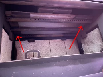

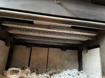

I had this insert installed a year ago and was happy for a couple nights until at around 2 am the blower decided to announce its presence with a very loud metallic buzzing. I unplugged it and went into the baby's room to put him back to sleep. Turns out the bracket holding the motor was bent and the motor wasn't fully attached, this unfortunately also ruined one of the rubber gaskets attaching the fan to the shaft allowing it to move and contact the metal bracket and wake babies. I got it replaced for free, and it seems these blowers are common failures so watch out for that. Today I pulled up the latest revision of the owners manual and noticed these baffle bracket aren't present on my insert. I pulled out my hard copy and this step isn' t there, but the part is shown in the parts list. I'm just wondering if yours has them and my installer didn't install them. The installer also put the side baffle covers on like this when I believe they are meant to be on top of the baffle on the two sides so my confidence in them is low.
View attachment 285631 View attachment 285642
Hi DackSkyrunner.
Is this is a Regency Cascade I1500?
The interior doesn’t look like mine. Our Air Tubes are of a different design.

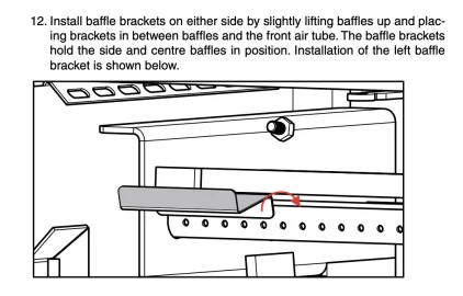

In any event, after a cursory look at the current Wood Insert Manuals on the Regency site, I don’t see ANY baffle installation that has metal pieces overlapping on the top of the baffle like yours.
If I compare our pictures (and we both have a Regency Cascade), you are correct-- the two metal baffle holders that I point to in my photo shouldn't be on the top of the baffle, they should be on the side.
There are also two small baffle holders that slip in on the top left and right.
If your installer got this wrong, that would concern me greatly. I would double check everything he/she did.
I’ll watch out for the fan. Thank you for the heads up.
View attachment 280834 View attachment 280837

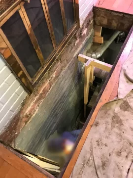

Hi ToastyRanch.
We had a wonderfully seasoned and wise installer (old and Yoda smart) who was with a chimney/masonry installation company. I let him do his thing. Because of that, I remember almost nothing of the specifics of the job.
I’ll be happy to explain what I do remember of our hearth extension build.
We have a 1920s house - I think we have 2 x 6 floor joists not 2 x 8.
There was a box existing in the floor that was already reinforced with extra 2 x 6s and blocking.
The concrete was pored into the box lined with rebar netting to a depth of 4 or 5 inches. We added two sheets of Micore 300 on top of the concrete. We placed our Quartzite slab on top of that sandwich.
I am so sorry that I can't remember exactly HOW the extension is tied into the floor and chimney.
My only concern was that we would achieve the thermal insulation/protection R value of 1.4 that is required by Regency for a safe install.
https://hearth.com/articles/chimneysweep/horvalue.htm
I double checked the R value of our installation at the above link.
Since your Insert is going to be installed so high off of the floor, Micore or cement board and a granite slab on the subfloor will get you very far. You can easily surpass the code requirements because you hit the 8 inch exception and have peace of mind. I am sure that the R value you require for your insert will be surpassed as well.
