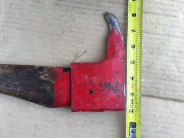

I bought a 36 inch one, didn't like, it and returned, then made one from an axe. Pic with red painted head. I used it a lot, until I made the hammer version.

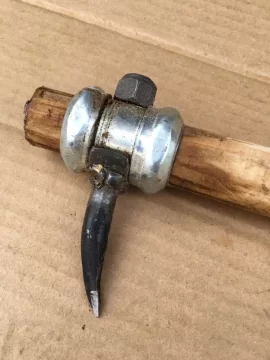

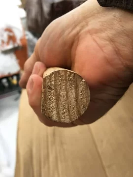

Made another from 6 or 7 ft of 1-1/8 diameter closet rod wood pole for hooking wood out of the trailer. This idea was from Harry on ASite. (I had made one long ago from conduit. Too heavy. Wood pole is plenty strong and much lighter, and can be used one handed.) Metal connector is a compression fitting for electrical conduit. It spreads the load out and reinforces the wood through hole. Hook is a 1/2 inch Gr 5 bolt. Forgot to measure, but I think about 3 inches past the wood pole to the sharp tip. Heated and air cooled to anneal. Ground to shape and benty slightly for the hook. Harry used a hex nut on either side of the pole. I tack welded a short piece of curved pipe on the lower side to prevent the hook from rotating. Then heated and oil quenched to add some hardness and strength back. I also cut about half length of the pole flat on the left side. Right handed grip, automatically aligns the hook end. I use this to unload every single piece from the pickup box/trailer. Very nice.

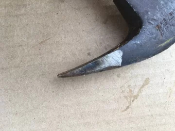

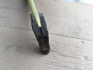

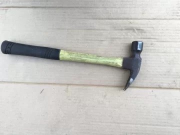

Latest, I made this from an old framing hammer that the owner had destroyed by pounding the face on metal framing bar. I ground the back side to sharpen the point, and the sides to narrow the points. I grew up using a bale hook on the farm, so am accustomed to an 'arm extension'. I use this all the time to reach across the splitter, pull rounds from the table or log lift, and onto the beam. One thing I found accidentally but the two points give a much better grip than single point. I can twist the wrist and turn the rounds. Single point hooks pivot and come loose. The two points stays bit and twists the round around. For two handed, I hook the far end of round with the hammer, and pick up the near end with my left hand. Big difference in how far I have to bend over. Love it.

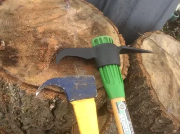

I made the blue one from an old axe head without a handle last year and once I used it, wished I had one years ago! The black one is a flat bladed pick I converted into one a few weeks ago. I have yet to test it, since the paint has no blemishes yet.

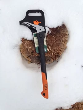

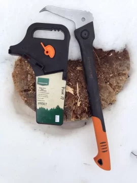

I've been wanting a pickaroon for awhile and I have 3+ cord to split and stack so reading this post got me looking online. On my way to the transfer station this morning I stopped at R&R Power equipment, the local saw shop. I asked what they had and they showed me this Forester model, at $25.95 the price was right but I was thinking I wanted something longer, I'm 6.3". Anyway I bought it and split about a quarter cord of ash and black birch and the pickaroon worked great. Saved my back. [Hearth.com] Pickaroon rocks[Hearth.com] Pickaroon rocks
