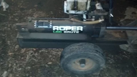

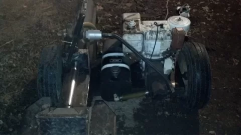

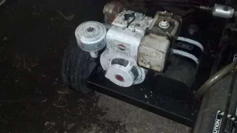

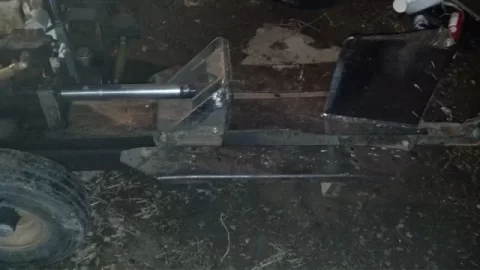

Got an older splitter for cheap that I'm hoping to get working. The I beam is slightly bent but it functions fine. Motor runs but the hydro is very slow. It seems to split fine just needs to be faster. Any ideas what I should do? [Hearth.com] Picked up a splitter slow cycle issue[Hearth.com] Picked up a splitter slow cycle issue[Hearth.com] Picked up a splitter slow cycle issue[Hearth.com] Picked up a splitter slow cycle issue[Hearth.com] Picked up a splitter slow cycle issue[Hearth.com] Picked up a splitter slow cycle issue
Depends on engine hp and cylinder size, could go go with a bigger gpm pump. Have to figure engine hp and what gpm pump is on it now
There is usually a pressure relief on the control valve. There is also a adjustment on the pump. That is the adjustment for when the pump kicks into second stage. Need to know if it is slow all the time or when splitting because increasing hydraulic pressure really wont make it any faster. More hydraulic flow or smaller cylinder is where speed will come from. Would probably be a good idea to change hydraulic oil and filter as well.
It looks to me like the relief adjustment on the valve is a fixed type. Check the pressure setting with a gauge to see where it is at, you may have a pump going bad also but without actual pressure checks we are just guessing.

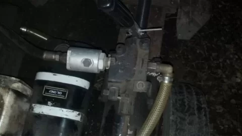

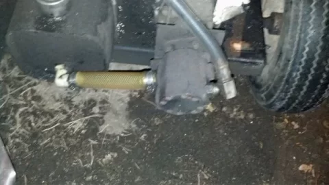

It is slow all the time. It has fresh oil and a clean filter.....wondering if pump may be going back? It gets noisy at the cranks shaft coupler. What should adjust based on these photos? I have no clue what does what[Hearth.com] Picked up a splitter slow cycle issue[Hearth.com] Picked up a splitter slow cycle issue
First we have to know what slow is, 10 seconds, 15 seconds, 20 seconds, for a full cycle and the length of stroke. Are you running at full throttle? Check the pump to engine coupler to see if it is slipping. I have never seen the device that is just before the valve inlet, could it cause a restriction in flow.
The pressure relief should be under the cap at the back of the valve that has the wire seal. A gauge should be installed be fore changing relief settings.

The silver thing in the inlet of the valve is a screen/filter. Take it apart and check it.

How would you straighten this beam? If you look the lip of the I beam is bent probably from somebody trying to pick it up. With a fork? [Hearth.com] Picked up a splitter slow cycle issue
Try taking better pictures in the daylight. It's hard to tell what is bent with that picture.

Oil is full would you guys recommend just checking all the fittings to see where it might be sucking in at? Also hers a picture circling the I beam. The lip is curled up so the ram pusher mounting plate is very loose in order to ride on that I beam. It still functions but I want to straighten it if i can[Hearth.com] Picked up a splitter slow cycle issue
It looks like just the top flange of the beam is bent from the pic. I would use a rosebud tip on an oxy/ace torch and a sledgehammer.
Can't tell how thick the flange is from the pic but I think it would be tough to bend back down without heat. But you could try with a big crescent and a cheater pipe.
