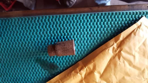

Picked up a splitter slow cycle issue
Well I completely removed the little brass filter. My cycle time is way faster now. I ran it for an hour and it ran perfect at a good speed. Still need to get a filter on there but as mentioned earlier in the post I've got new hydro fluid. I know I may risk the pump but wanted to give it a good run plus I had stuff to split! I will be on the lookout for an auto type filter. I could try to replace this one but honestly it doesn't look that bad unless it dirty and I can't tell. THanks for the help,

not able to find that replacement filter pictured above. It looks like i should be able to fit the can style on there without any line modifications....may have a little extra in one hose but that will be ok. I'm going to take my original filter housing in with me so i knwo that the new setup will work with my valve and connections. Anybody know how bad it would be to keep running this without a filter? for the long term I want a filter but would like to be able to use it this weekend until i can get the part.

Judging by picture number 5 in my first post . The inline filter looks to be on the supply line doesn't it? Is it ok to put a filter in the same spot?
Depends on the filter. Not all filters are made for a high pressure situation like that. Needs to be a specific high pressure filter.
I would just put a spin on one on the tank inlet, filter the return.
If I can get a spin on that will work here it will bolt right up with no modifications.
You can't install a spin on style filter on the pressure side of the valve. It needs to be on the return.
ok, so i should probably just replace this one then. otherwise i'm looking at 2 new hoses, and some extra fittings. think i'll try to finda replacement filter jsut like this one so i can bolt on and go.
the current inline filter is on the pressure side of the valve.....it must not work the same as a spin on. i could leave it as is without a filter installed, and then put a spin on style on the return, but it would be hard to do unless bolted righted to the return with a fitting and then some how a fitting to get the large return hose over the new spin on adapter
i think rather than spendn early 100 to geta spin on filter, i'll just run this without a filter and when the pump goes, i'll replace it and freshen up the oil. easy enough.
