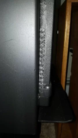

So an update, I saw you guys and your points. Just for some clarification. The air wash at the bottom of the stove is unregulated air about a dime sized hole My plan was to build a small cap that in the event of a chimney fire I could close the air intake on the back to seal off the bottom of the stove and smother the fire. From what I can tell the secondary air tubes are controlled by the damper rod and the AAS system.
Now for the gap, I check the gap again and it is about 1/32 of an inch for close to 4" long (1/32" in the center of the gap and smaller at the ends) and you can see where the gasket is contacting the stove face and where it isn't. I checked the flatness of the stove opening and the door. Both were bowed the stove face was 1/32" bowed inward at left 1/3 and the stove door had the same 1/32" bow. Once I shut the door and the gasket was squeezed between the door and the stove it left a slight gap about 1/32". Now I realize these are "Air tight" stoves in a sense that it still has the uncontrolled air inlets but I don't want to be blowing through wood or leaking any sort of smoke back into my house via a bad door seal. I am in contact with Englander and I hope we can remedy this problem for myself and people to come even if it means just adding a thicker gasket (which I think will be my case). I like the idea that when I call their help line a person that speaks English answers the phone and I can understand what they are saying, this is huge in my book.
EDIT: I will take a few photos tonight to show you guys the bow I am talking about in the firebox and the door. If the firebox wasn't bow/warped there wouldn't be a sealing problem. Kind of odd how the both are warped.
Since the door is hinged on one side and the latch that applies pressure is on the other, I think I would prefer a slight bow inward of the door. My thinking is that as you tension the latch side, you will flex the door flat. The stove I would want totally flat. Mine is not and it has nothing to do with heat, it was made that way. As I said earlier, they bend these things in a jig and I can easily imagine how the center between two sharp corners is bowed inwards.
I'm with you. If the bow was the other direction of the door it would seal up tight no problem. Stove wise if they added a slightly raised area inside the jig so it would only flex outward when clamped they would be set in that aspect and it wouldn't become concave. The door is cast so I wouldn't see how it was possible to really change that but you could definitely work the jig enough to keep it from happening.

As promised pictures.
These first 2 are of the door.
[Hearth.com] Picked up my Englander SSW02 (Big madison)[Hearth.com] Picked up my Englander SSW02 (Big madison)
These are of the stove.
[Hearth.com] Picked up my Englander SSW02 (Big madison)[Hearth.com] Picked up my Englander SSW02 (Big madison)[Hearth.com] Picked up my Englander SSW02 (Big madison)[Hearth.com] Picked up my Englander SSW02 (Big madison)[Hearth.com] Picked up my Englander SSW02 (Big madison)

Oh, the door is bowed outwards. Opposite of what I thought you were saying. Stove bowed inwards. Your bananas don't match!
Reactions: Chas0218
Yeah, if they were bowed the same way I would be golden I think. They are starting to think it might be a hinge issue that the dogs that hold the pin are too long and not allowing for full contact.
I would return that stove if it was me you will never get the door to seal properly
I'm working with Englander to see what their fix is. I am going to press the issue a little and see what they decide to do.
To me the only acceptable answer is a new stove.
Better check that one too. They're probably all like that. Mine is too, though maybe not quite that bad!

I just got off the phone with tech support and long story short they are sending a new stove also going to be checked before it leaves the factory. I think the main issue with the stove was that the hinges were a little too long keeping the gasket from being squeezed enough by the door. I included some of the photos they requested on the hinge side of the door. Like I mentioned there was a small gap about 1/32" after the door was shut and was towards the hinge side more than the center of the stove. I'm impressed with the customer service and how they stand behind their product. I wish I didn't need to use the customer service I'm happy they were easy to deal with and they didn't blow me off. Before I give Englander my nod of approval I want to see the new stove to make sure everything is good with that one. I will take my level and flashlight with me when I inspect the new stove just so I don't have to load and unload it into my house again.

Me too, one of their shop techs took a look at the stove and said that it is un-repairable and needs to be replaced with a different unit. My guess is once they get the stove back they will cut the hinges off and weld them back on a little shorter to put more pressure on the gasket as it should have been like that. I'm hoping that their fix doesn't cause the door to warp and lift away in other spots.
Ideally they should modify their jigs to keep the stove from bowing when bent and maybe making the hinges slightly shorter. I think it would be simple if they supported the entire front of the stove during the bending process, I'm not a tool and die maker but went to school for it and I don't know how they are bending the front of the stove inward when bending the rest of the stove. With all the forces put on the stove when bending it should bow it outward.
