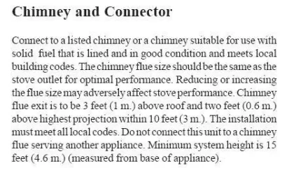

So the "base" of the stove means the bottom of the stove firebox i take it ?

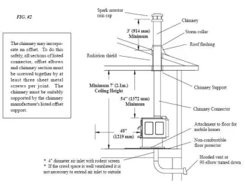

Well you are guys are making me feel special, thank you. OK, what do you think do I need 15 feet from bottom of stove to chimney cap, buying another 3 feet?

Just to review, I have 11 feet of pipe, from stove collar to cap, maybe a little more than 11 but not that much, maybe 11'6 at max. I guess if the manual says 15 feet from base to cap adding another 31 inches, I am not that far away. I will at the very least add 3 foot section and brace. Is is easy number one to add a 3 foot section my self. I know the brand they put it and also putting a brace on, is that easy also on a nice warmer day....

BrotherBart said:
Manual currently says from the bottom of the "appliance" Spike.
Edit: So for the Summit it would be chimney height plus 31" for total flue height.
The "base" of the summit is meaning the bottom of the firebox would be 19 1/2" , to the floor it would be 28 1/2"
I would think it would to to the bottom of the fire box because under the fire box wouldn't have anything to do with draft. But I'm just guessing.
another 3' sounds right JFK .

Roospike said:
I stand corrected ole" brother bart. good catch .

this has been a good post the solution was hashed out. Imput from all has been educational.
